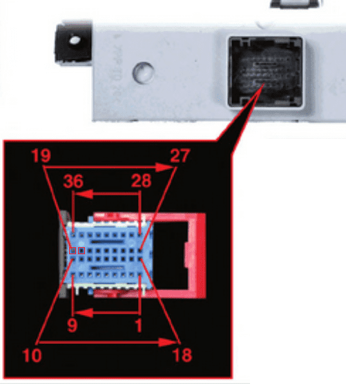

One more thing I'm a little confused about. You mentioned, that wires should be connected to PIN 19 and 20 in connector D on B001, which is actually the fuse panel. According to electrical drawings posted ealier, the wires are going to PIN 19 and 20, but on M001, which is BSI/BODY (whatever we call it). Are we sure about where to connect the wires? :thk)
I'm wrong, connector D should be this:

Another question is, if you're sure about the numeration of PINs on the photo you posted. It seems, that there is physically only one connector, but it's splitted to 3 sections - C, D and one more - it looks like A.
Am i right? If the part D is containing PIN 19 and 20, the numeration must be different, because PIN 19 and 20 should be somwhere in the bottom part, where you marked PIN 1-9. Do you have any diagrams, so i can take a better look?
I noticed this difference between Sport Button layout (C-D-?) and standard connector, I was thinking that it could change the body computer connector in Ducati Corse...I do not know.
We must understand this difference.
In standard Body Computer, pinout connector seems correct, so Body Computer maybe is different....

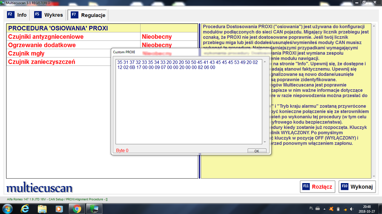

I tried to check custom PROXI with FES, but there was no action after pressing key combination (alt+ctr+c), so I installed MES and it was working fine. I don’t what was the reason, that in FES it was not working, but never mind. Below there is BODY configuration from my Q2, maybe it will say us something when we compare it with yours.
When I’m looking in EPER we could have 50504852 (let’s call it standard), 50513043 (E4XD) or 50513041 (E4XD+…). The one you mentioned (50504854) was dedicated also for South Africa, but it seems that it could also fit to our cars. I think all those computers look same when it comes to hardware and the difference is the body configuration, so they are numbered different. I think it's possible to check using FES/MES, will look for it tomorrow.
I have mentioned 50504854 because my Q2 is with E400 - LONG OPENABLE ELECTRIC SUNROOF and only Body compatible for my Q2 with E400 By ePER is 50504854 and 50513041, but i don't have Sport Button,so only a compatible Body remains: 50504854

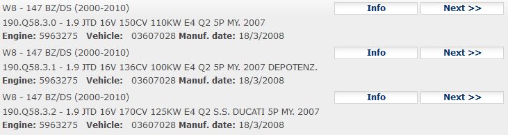

A curious thing is when I enter the VIN number in ePER, it show me a window with 3 choiches available:
